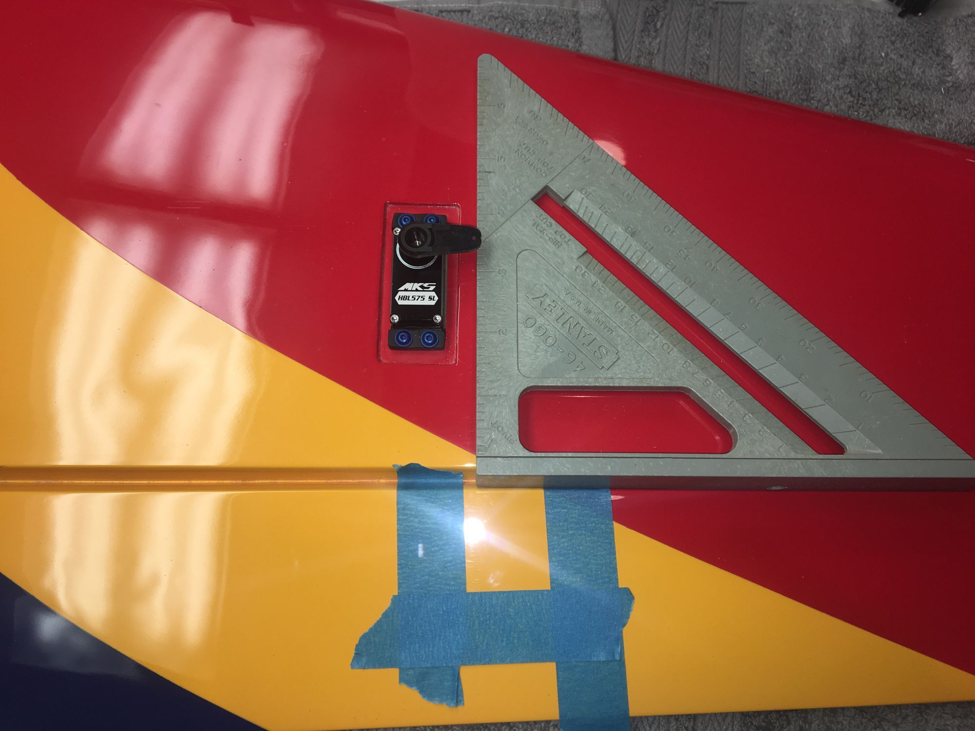

I want the servo and linkage perpendicular to the hinge line. The servo cutout already is. The linkage hole on the horn is 11.5 mm from the edge of the servo case. This puts the horn near the edge of the installation block.
