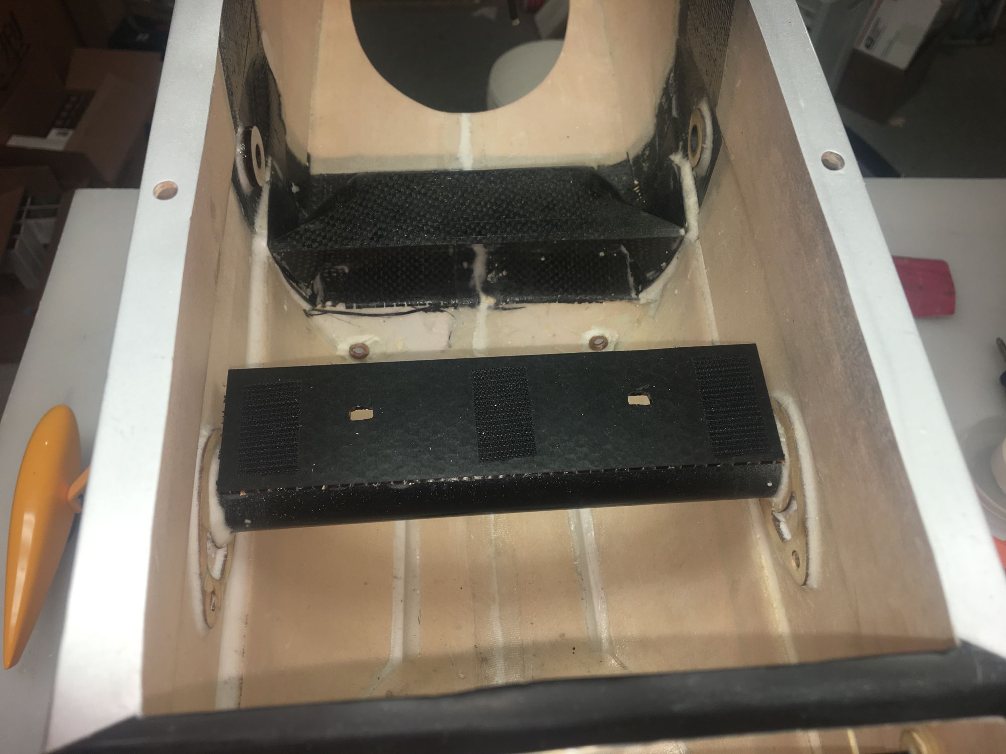

My equipment tray is made from 1/8" CF Nomex honeycomb composite. I am not a real fan of this material as it is difficult to glue the edges on it but it worked OK for this purpose and is light and stiff. It is glued to the wing tube and will support the receiver, batteries and regulators.
